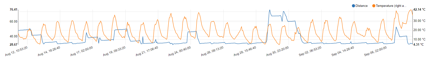

    I built a water level sensor for my 80,000 litre water tank based on the JSN-SR04T-2.0 ultrasonic sensor about six months ago. It is powered by 3 AA alkalines and therefore relies on being in sleep mode for most of the time.
    ![alt text](0_1567755826897_AJH_4070.JPG image url)
    I have experienced similar problems to many on this forum with the apparent unreliability of this sensor. In general the device spends most of the time reporting the correct water level but then has episodes of spurious reading which normally present as a depth to water level of around 220 mm. I had been thinking that I was plagued with condensation effects and I have been attending to reducing condensation with some limited success. In the last few days I have been seeing a pattern where temperature change might be influencing rogue behaviour.
    I have included a thermistor in my water level sensing package so that I can do some temperature compensation of readings. This has the spin-off that I can monitor the air temperature in the tank. I have noticed over the last 5 or so days a distinct pattern where the 220 mm anomalous reading occurs when the temperature is in the range of say 13 degrees to 20 degrees celsius. Looking at the attached chart which superimposes temperature and depth to water readings it can be seen that the correct water level is being reported over night but as the morning warms up it goes bad when the temperature hits 12 to 15 degrees and stays bad until the temperature warms up to about 20 degrees. The reading then stays good during the middle of the day but as the temperature falls below 20 degrees the reading goes bad again and stays bad until the temperature has fallen to below 12 degrees or so.
    I would be very interested to learn of anyone else who has observed a similar temperature influence on water level readings.

      @timbergetter A curious one, my guess would be direct sunlight on the diecast box and the copper pipe cooking the US board or the connections?
      Both my installs are in plastic boxes and facing north, but air temps vary from 15 to 35 currently and do not affect the board (never measured the case temperature).
      The only temp anomaly noted here was condensation drips forming on the heads at below -10 (Heatsinking via the steel conduit mounting), both tanks (Sewage and raw water) are underground so the temperature drift on the actual US head is minimal.
      Only the sewage board is giving me false readings when below 50% which I'm convinced from earlier itterations (5v v 3.3v) are down to the lower voltage. Why this anomaly is on one board and not the other is baffling but will experiment in a month when it's emptied again so it can be relied on through winter.
      Perhaps a polystyrene surround to your box will both shield and protect?

        Curious is the word. If it were an overheating issue then I wouldn’t have expected a return to stable operation while ever the temperature is above 20 degrees celsius, but I’m not ruling anything out at this stage. I noticed in one of your past sketches that you used 150 microsecond pulse-width ahead of the pulseIn() command. I am using 10 microseconds there and I cannot remember how I settled on that. I think 10 microseconds is the absolute minimum to trigger the jsn. I might play with that next. I am still running with the original set of batteries so the supply may have fallen to low volts by now so I’ll check that too. I thank you for your input.

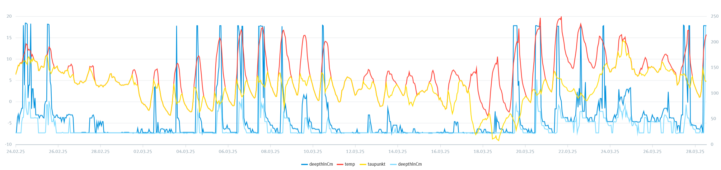

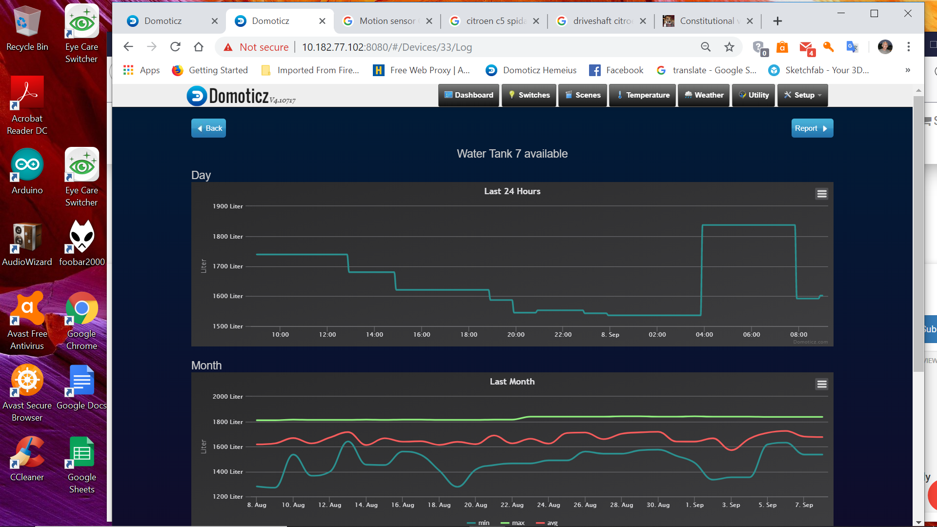

                        @Timbergetter I also tried the JSN SR04T sensor and had problems with it. Ended up using the cheap HC-SR04 sensors on my tanks. Have 3 different tank sensors - borehole water tank up the hill, rainwater tank at house and another reverse osmosis filtered water tank. All three going for just over a year now.
                        Condensation issues / waterproof I resolved by quickly spraying some clear laq spray paint over the sensors. On one tank I also added little standoffs so the sensor is not sealed onto the lid of the tank but rather 5 to 10mm above the lid to let the ambient air pass over and prevent high humidity inside the tank condensing on the sensor.
                        And then for the code ... I added LM35 temperature sensor and added temp compsensation. Also I do a few readings and average them out.
                        All-in-all I now get only one or two weird readings on rare occasions - could be a spider !
                        Here is the last day data of the tank I have up the hill. Its showing pump cycles as well to keep tank topped up - its a weak borehole so i can only pump a little at a time. I have a separate node with relay to turn on/off pump as well as float switch down the hole to detect low water levels in the borehole.

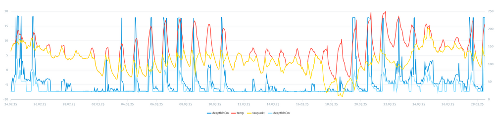

                        Here is a one week graph of the same tank : temp and distance only shown
                        Here is one month data
                        We are just coming out of winter here (in South Africa!) - so temp swings of the air inside the tanks are quite radical between day and night (except the last 2 days its been getting rather warm here !)
                        Basically - just wanted to let you know/see that the cheap HC-SR04 sensors can do the job - and no more hiking up hills to check tank levels - and also the pumping can be automated too by the controller

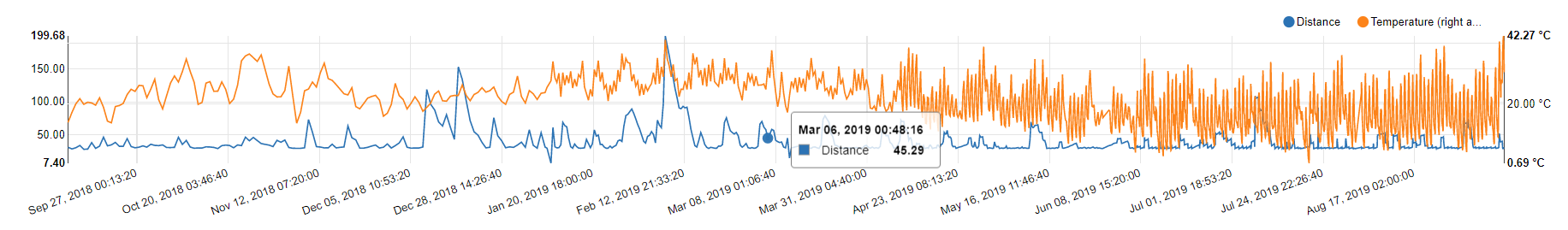

                              @zboblamont Oh - and its not really winter anymore here - only goes to last month in the screenshots previously shown. Not sure where you're from - but temp inside tanks here range from 0.69 C to 42.7 C - min / max for last year
                              Here is the last years graph for interest sake !

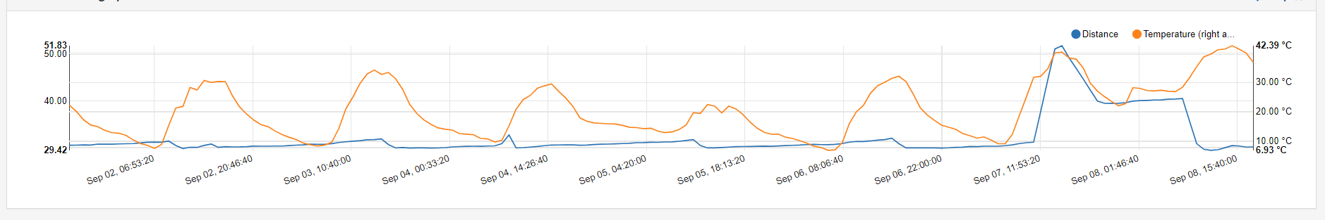

                                There is a lot of very interesting observations and suggestions coming to light here and I thank everyone for their input. No-one seems to have experienced the exact observation that I have made, however I may not have defined this exact issue very well, so I’ll add a bit of clarification with this figure:
                                You may be wondering why the water level is stuck at 1.1 metres (depth to water) for days on end. This is a relatively large tank at 80,000 litres and outside irrigation season not much water is used. It’s just supplying water to my house at present.
                                The last few days have been cold with maximum temperatures below 10 º C so no spurious readings and no troubleshooting possible.

                                  @timbergetter said in JSN SR04T - Temperature Influencing Readings:
                                  The level variation makes sense now.
                                  No clue what is going on with temp electronically, but couple of anomalies on the 1st fall outwith the perceived problem range briefly. Stumped what could be going awry with the board/head short of a dodgy connection.
                                  I run max 10 readings looking for 2 consecutives within a defined range, but in your case you are reporting a value you know is incorrect?
                                  Perhaps you could reference previous reading in the sketch to assess whether to send in the bogus signal? As your decay over time should be predictable (during irrigation season) perhaps not reporting the anomaly might be an option?

                                        Your false readings are uncannily close to the deadband of 20cm on all your failures for what it's worth.
                                        I have one strangely behaving board, and one operating perfectly in stable temperatures but high humidity. I will experiment when the problem arises after the tank is emptied in 3 weeks, but curious what you've tried in the last 4 days?
                                        S T 2 Replies Last reply
                                        • zboblamontZ zboblamont
                                          @timbergetter Not labouring the point at all, but what have you changed which might help narrow the problem?
                                          1 - Did you review the sketch to verify the reading is double or triple verified and not reported if false compared to expected range or previous reading? Clearly not as you are still reporting incorrect readings.
                                          2 - If the connections are Dupont, have you checked continuity for a dodgy wire, or even better soldering terminations to eliminate thermal expansion of contacts from possibilities?
                                          3 - Have you tried changing the materials used for casing and conduit from thermal conducting metal to insulated material or see if insulating the case made any difference?
                                          As @slt1 kindly chipped in with a climate not unlike your own he couldn't get the 5vJSN to reliably work and elected to go with a modified twin transducer which he found reliable.
